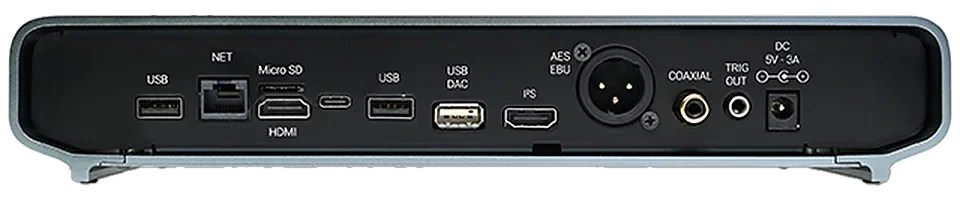

The back of Rivo Plus, labelled from left: USB, NET, Micro SD, HDMI, a USB-C port, USB, USB DAC, I2S, AES EBU, COAXIAL, TRIG OUT and DC 5V-3A.

Out
USB DAC
USB-A 2.0 with power filtering
I2S
HDMI connector with adjustable pinout routing
AES/EBU
XLR connector, fed by the dedicated ASIC
S/PDIF coaxial
RCA connector, fed by the dedicated ASIC
HDMI
Mirrors the Volumio app on your TV, up to 4K at 60 fps
Trigger
12 V on a 3.5 mm jack, positive on tip

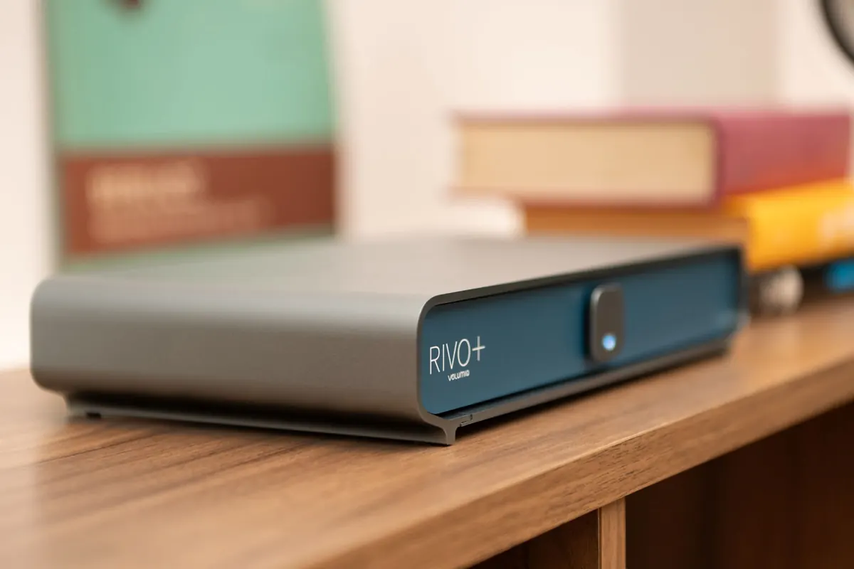

Rivo Plus in the Classic finish on a wooden shelf, in front of a stack of books.
Classic
A deep blue front with a square button, in a grey case.
