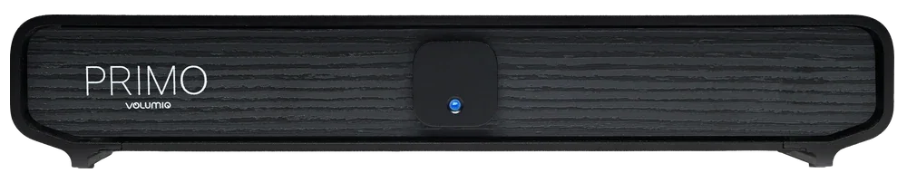

Volumio Primo V3 seen from the front left: a black case with a wood-textured front, the Primo name and a square button with a blue light.

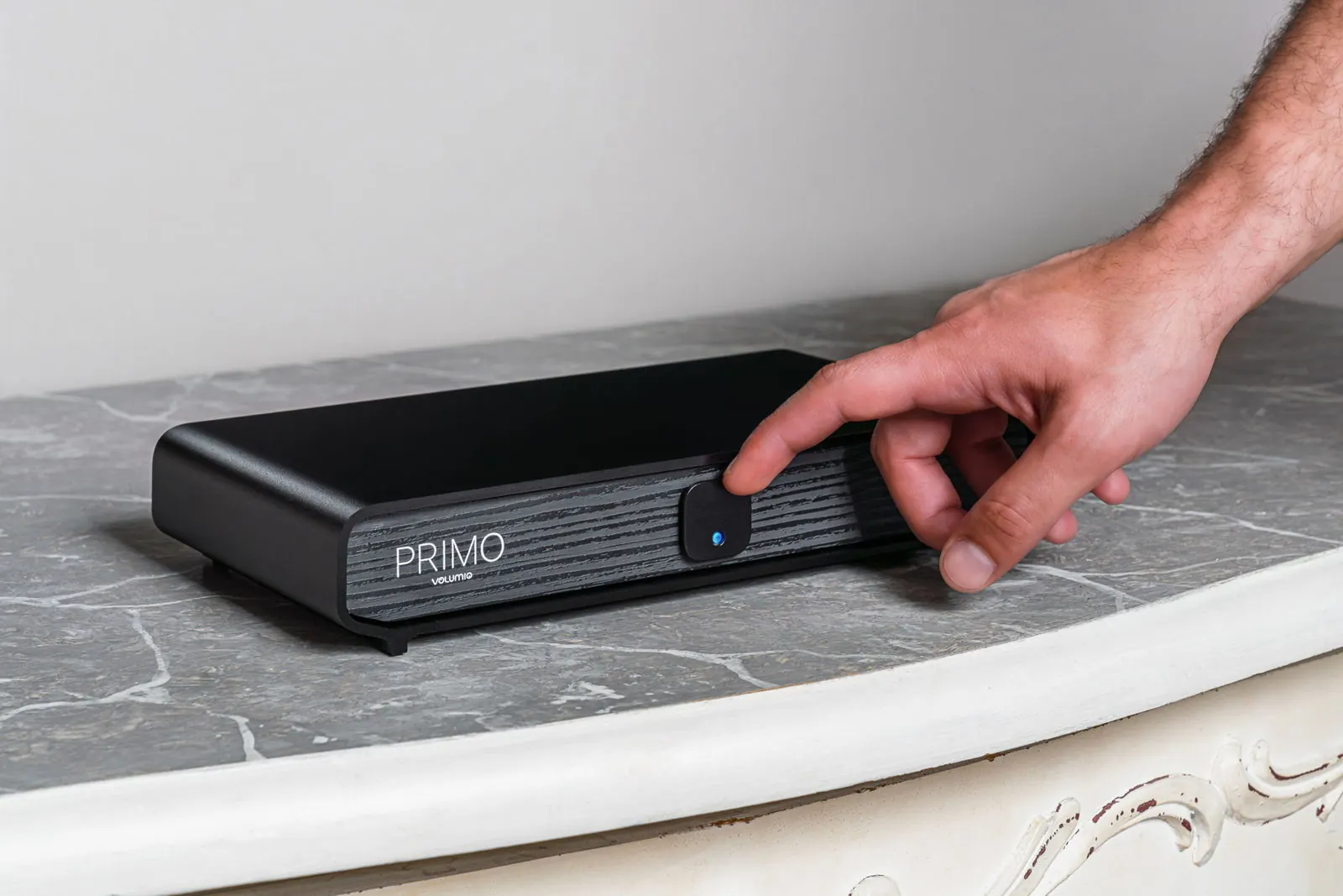

A hand reaching for the button on the front of Primo V3, which sits on a grey marble top.

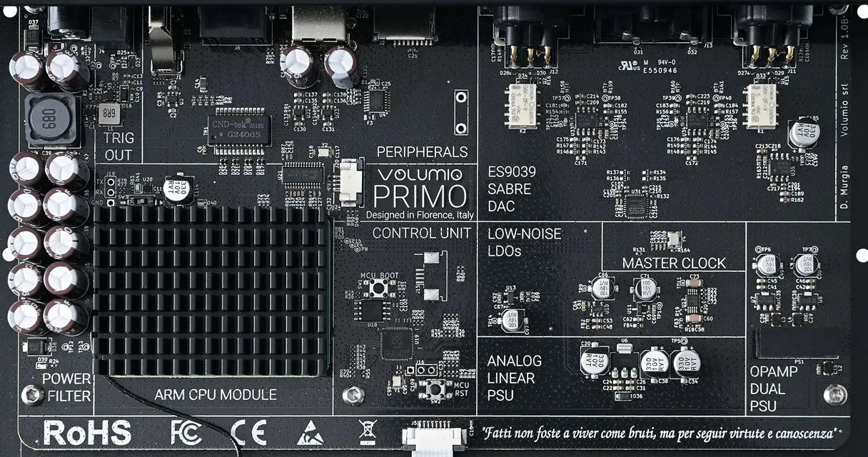

Engineered for sound
Primo V3 is a complete redesign of the original Primo. A linear power supply stage and a high-precision clock keep noise and jitter low, and the layout keeps every current path short. Along the edge sits a hidden nod to Florence. Pick a part to find it on the board.
The Primo V3 main board, with each section named on the board: ARM CPU module, control unit, peripherals, ES9039 Sabre DAC, low-noise LDOs, master clock, analog linear PSU, op-amp dual PSU, trigger out and power filter. A line of Italian verse runs along the bottom edge.

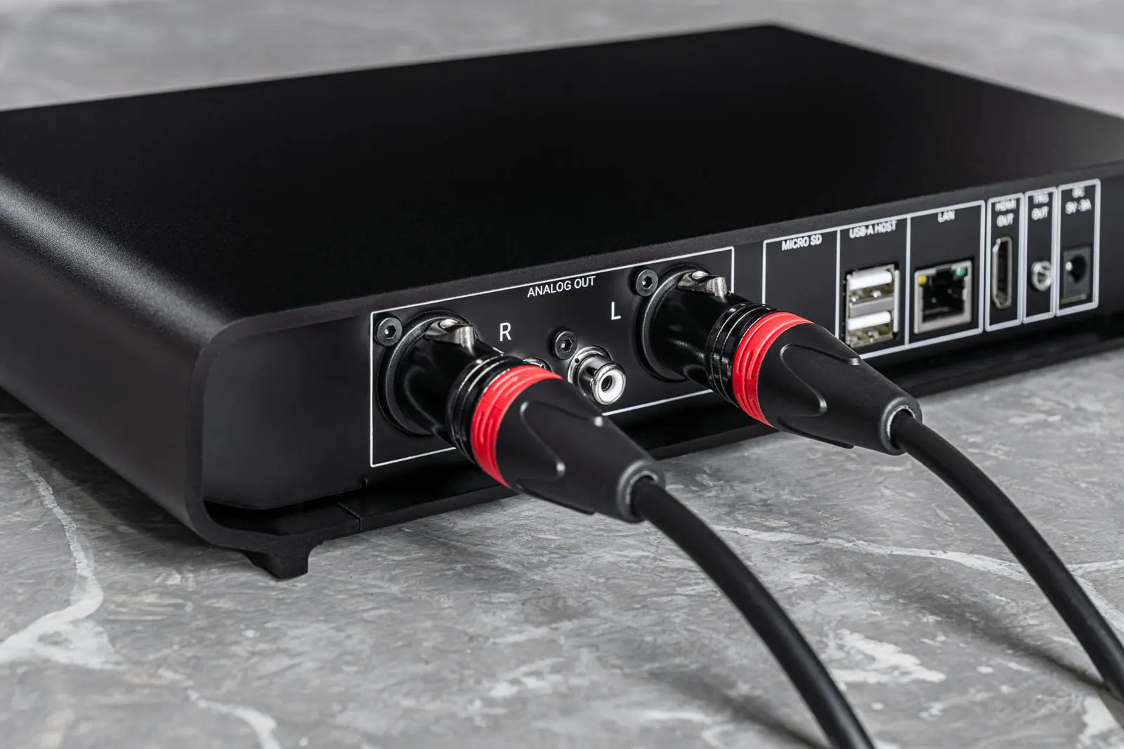

The back of Primo V3 on a marble top, with balanced XLR cables plugged in.

Out
Analog
Built-in DAC, up to PCM 384 kHz / 32-bit
Balanced
XLR, 1.00 to 6.30 Vrms in 8 levels
Unbalanced
RCA, 0.50 to 3.15 Vrms in 8 levels
USB-A × 2
To a USB DAC, up to PCM 1536 kHz / 32-bit and DSD1024, with multiroom off
HDMI
Mirrors the Volumio app on your TV, up to 4K at 60 fps
