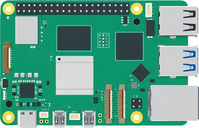

A phone or a PC/Mac playing Spotify. A Raspberry Pi with Volumio OS.

Every phone and PC/Mac has a small one behind its headphone jack. A USB DAC, or a DAC board on a Raspberry Pi.

The device guide asks what you have and suggests a Volumio device. Or build your own streamer with a Raspberry Pi.
