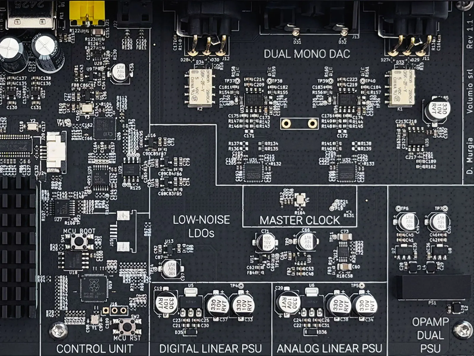

Look inside
Every part has a job
Primo Plus was designed from scratch around cleaner power, lower noise and a more precise clock. Pick a part to find it on the board.
The Primo Plus main board, with each section named on the board: control unit, low-noise LDOs, dual mono DAC, master clock, digital and analog linear power supplies, and the op-amp dual power supply.

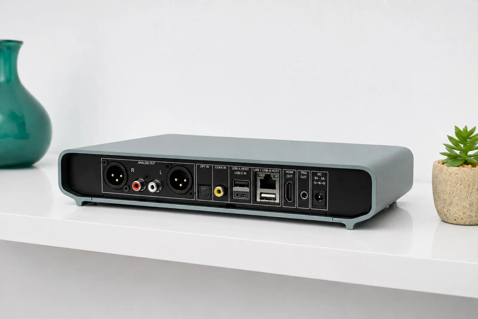

Connections
Plug in everything
Stream over the network, or connect a computer, a TV, a CD drive or a hard disk. Then send the signal out balanced or unbalanced.
The back of Primo Plus on a shelf, with its audio, network and USB connections.
In
Network
Gigabit Ethernet or dual-band Wi-Fi
USB-C
From a computer, up to PCM 768 kHz / 32-bit and DSD512
S/PDIF coaxial and optical
RCA and TOSLINK, up to PCM 192 kHz / 24-bit
USB-A × 2
Flash drives, hard disks and CD drives
Bluetooth
Bluetooth 5.0
Out
Balanced
XLR, 1.00 to 6.30 Vrms
Unbalanced
RCA, 0.50 to 3.15 Vrms
