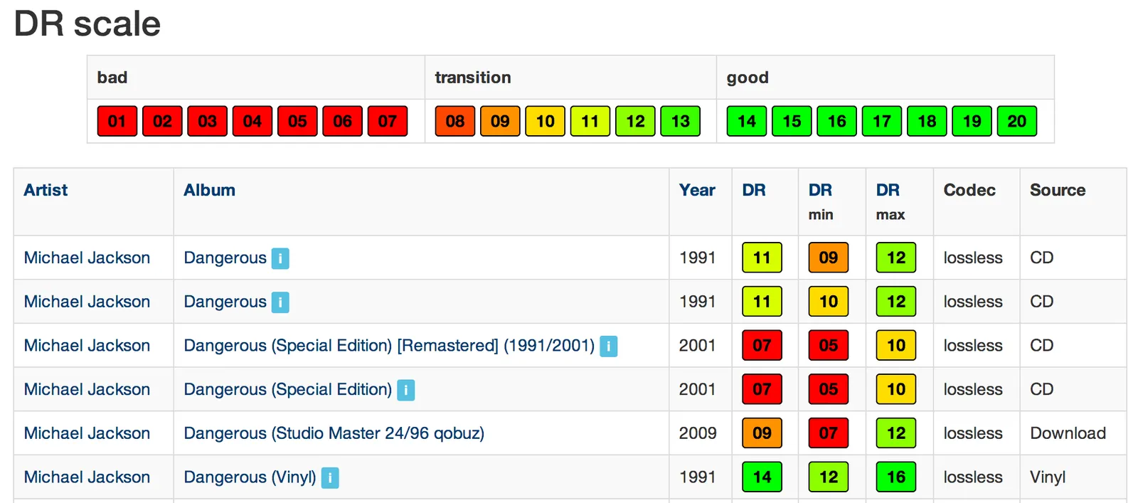

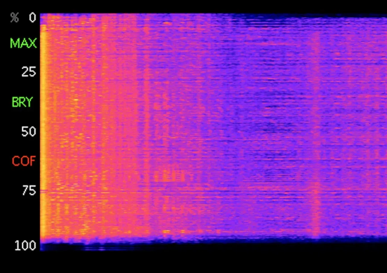

Below is an image that displays the dynamic range of Michael Jackson’s Dangerous trough the years. As you can see, the album’s dynamics have been progressively compressed until getting under the bad side on the DR scale unlike the imprinted and uncompressed files that have a good DR scale. For a detailed and comprehensive explanation, head to the excellent article “It’s the mastering, stupid! ‘How record companies are ruining music” .
Dynamic Range of MJ’s dangerous across a decade, image from tcervo.com
The understanding of what dynamics are and the range it has plays a key role in the quality of artwork because it displays to the listener what is not only real but also a good sounding audio file. In order for a file to sound good to the ear it must have a good dynamic range and a good dynamic range comes with a balance between a pleasant volume of highs and lows along with the original natural sound.
Long story short: evaluating your file’s dynamic range is a good method to grasp their resemblance with the original event, and the care taken in mastering such musical information. Let’s see how you do it.

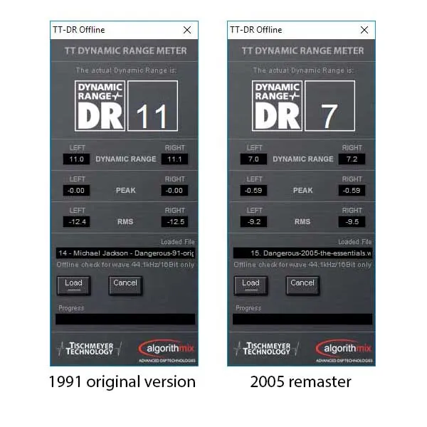

A first method is using Dynamic Range Meter, which will give you a result in form of a number. It ranges from 1 to 20, with values lower than 8 being absolutely bad, values ranging from 8 to 13 begin good but not optimal and values greater than 13 being excellent. Basically, greater the value, greater the Dynamic Range. You can read it in full depth (and compare several measured values) at the Loudness War Info page. So, let’s compare the values of the same song from Michael Jackson, Dangerous, in two different releases (with two different remastering processes). The left one is the original version, with a good (altough not great) DR, while the remaster performs significantly worse.

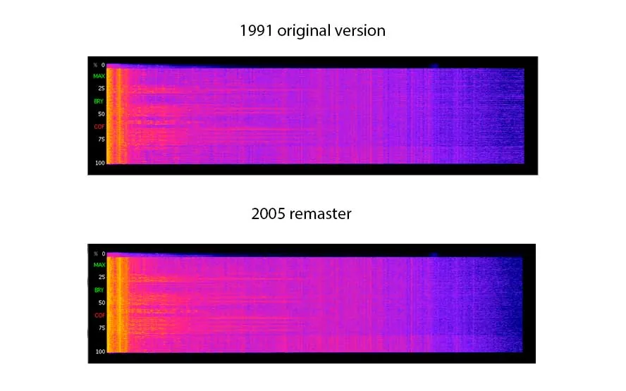

We can have a further insight of what the difference are using MusicScope and its clever Spectral Analysis tool, which we’ll be covering further in the next section. You can visually see the dynamic compression in the second image.

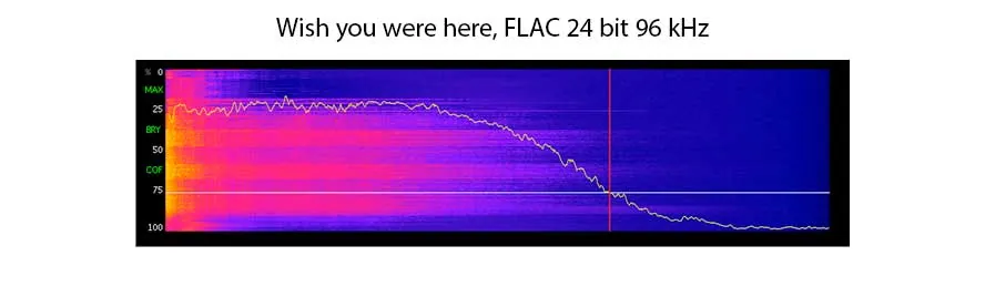

To tell if a file has been converted from a low quality one to a high frequency one with spectral analysis you want to identify if there are “holes” in the freqency ranges, or if there are frequencies cut-off (musical informations are not stored above or below a certain frequency).
For example, let’s compare the very same track, in this case Wish You were here (from a 24/96 FLAC from master) with different encodings. All measurements are taken with SoundScope’s excelellent Spectrum Analyzer. The below image shows the original file, with all its frequency extension.

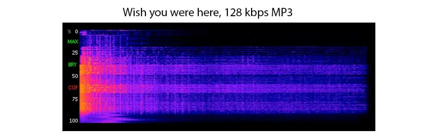

Now, we do something funny: we convert this FLAC to 128kbps (CBR, constant bit rate) MP3. Just by looking at it you can understand how much of the original music message has been lost.

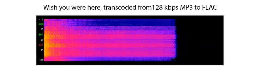

And now we do something really weird: we transcode our nasty MP3 back to hi-res FLAC format. At this point you might ask yourself: what’s the point of converting an MP3 back to FLAC? Actually none. But it’s a good way to demonstrate how the starting point of the musical encoding matters so much. Especially when you think on Hi Resolution files that you can buy from specialized websites: they will be actually Hi-Resolution ONLY if they are encoded from the master recording, and not (as sometimes happens) from CD Quality recordings. This practice is called transcoding,
You can clearly see how the transcoding emulates in a linear manner the Spectrals of the low quality MP3. And this is the trick that allows us to spot transcoded files from lower quality.
