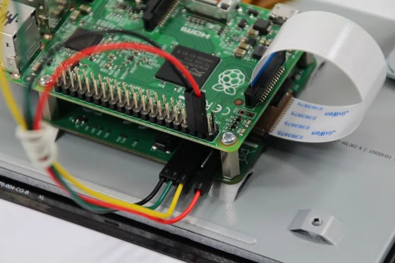

- First, let’s attach the ribbon cable going from the Raspberry PI Display to the PI itself. On the Raspberry PI Side, make sure the blue part of the ribbon cable is facing outwards. Your final goal should look like this:

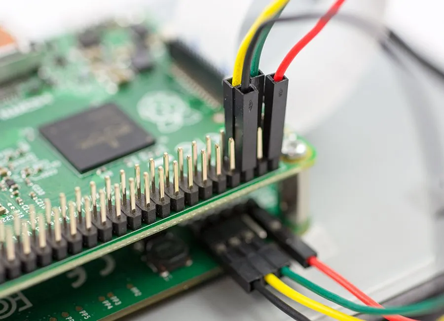

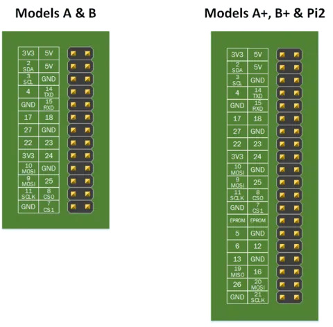

- You’ll have 4 coloured cables to connect too. They are 5v, GND, SDA and SCL. You can look at the below image to identify the proper pin on the Pi itself.
Therefore, the wiring should look like this
Done! You’ve done the wiring required to connect the Raspberry PI official touchscren, let’s move on!

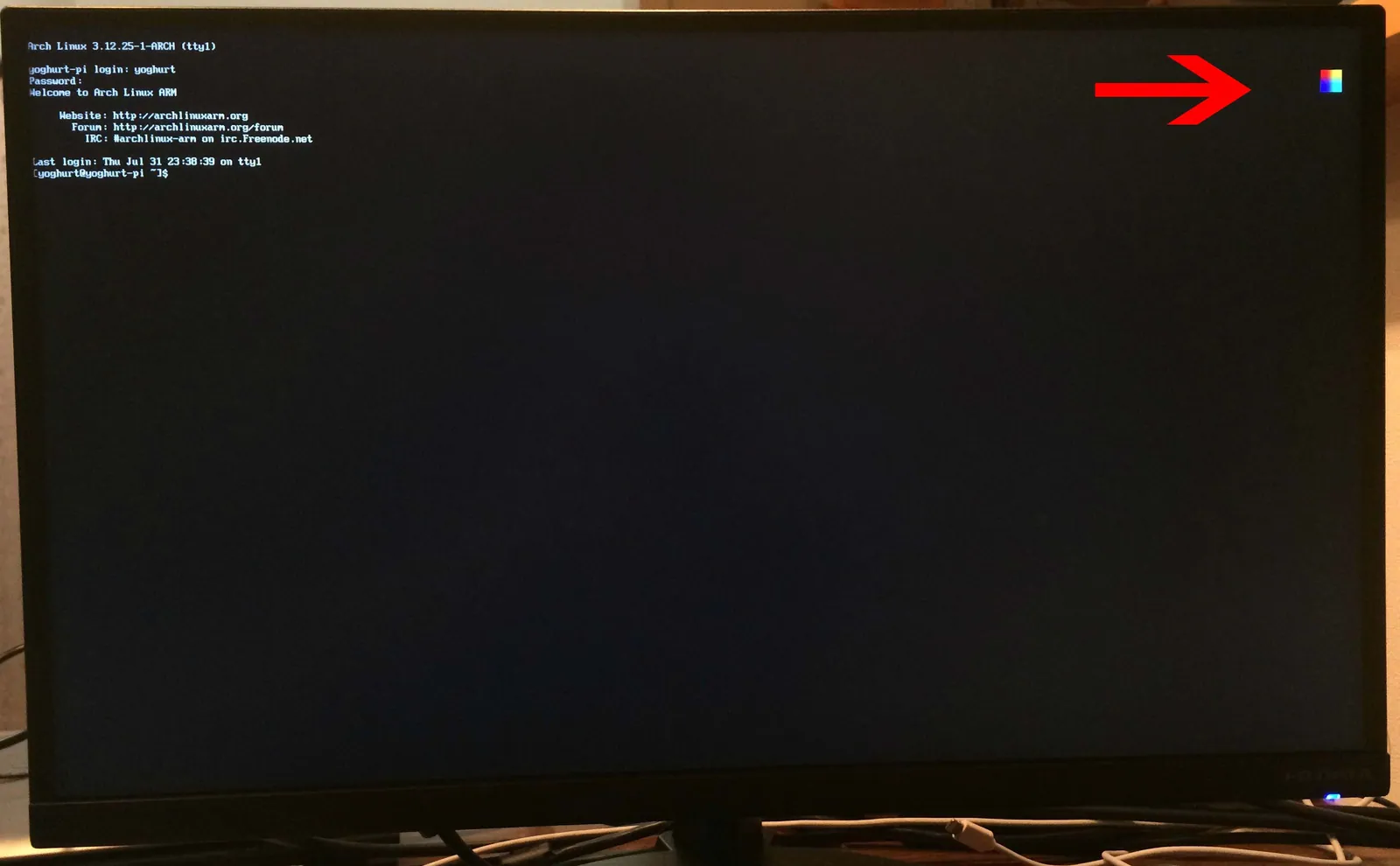

Notoriously, feeding your PI with an adequate Power Supply is mandatory to have a reliable system. That’s especially true when we connect a power-hungry device like the Raspberry PI Display. Luckily, there’s a way to understand if your PSU is good enough: just power on your pi and observe the screen, if you see a coloured square on the top-right side of the screen, it means that power to your PI is not enough. Don’t you see it? Then all is good.
If you have such problems, don’t worry. Good power supply are cheap and easy to find. Here’s the NorthPada 5V 2000mA PSU, my personal favourite.

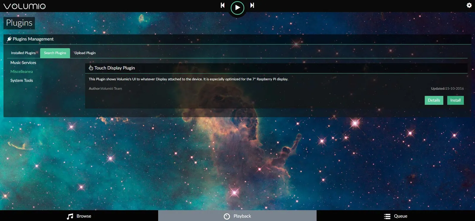

STEP 3: Install Volumio’s Touchscreen plugin

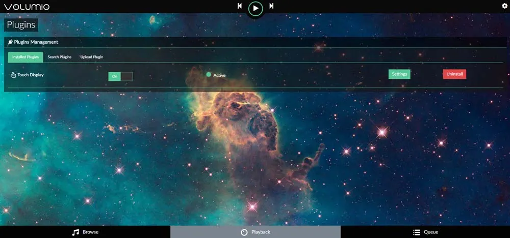

That’s the easy one. Just connect to Volumio’s WebUi as you would usually do, and navigate to the Plugins page from the settings menu. In Miscellanea category, you’ll find the Touchscreen plugin. Just click install, nothing more. PLEASE NOTE: The touchscreen plugin is compatible with volumio version from 2.001 onwards
The installation will last about 7 minutes, so wait patiently until you see “Installation Complete”. Now you can enable or disable the Display output to your likings.

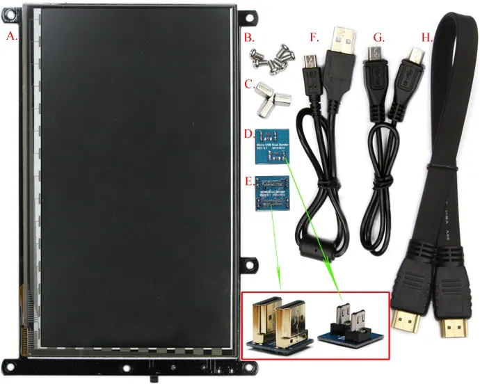

THE ODROID DISPLAY
The Odroid display is not only a viable alternative, it also have several advantages over its PI counterpart:
- Since it takes power from USB and video signal from HDMI, it can be used virtually with any Computer with an HDMI output, not just the Odroid or the Raspberry PI.
- It has a better resolution: 1024 x 600 vs 800×480 of the PI display
- It’s somehow simpler to integrate into a beautiful case (thanks to its mounting holes)
- You can still use an I2S DAC with the Display, since it does not use any GPIO port (both on Raspberry PI and Odroid)
The Odroid Touchscreen display is available at Odroid’s webshop or on Amazon
