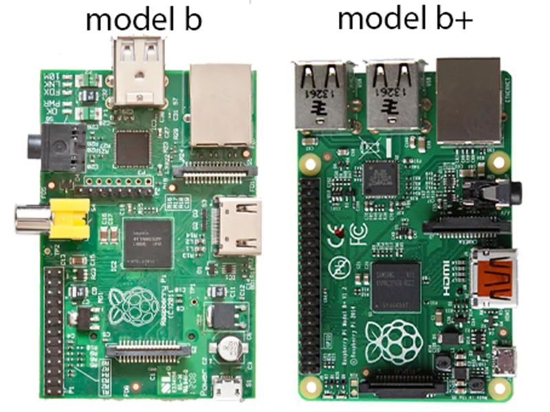

First thing we notice: almost everything has changed its position: Power Connector, HDMI, Camera Connector, Analog Jack, USB Ports, GPIO Pins. And now the bad news: that means lots of Pi oriented accessories are not compatible with Raspberry Pi model b+.
Cases, Expansion headers, I2S DACs and lot more stuff will simply not fit. So, if you plan to use Raspberry Pi model b+ with your existing accessories, you’re just out of luck.

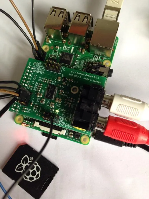

But, as always, the solution is just waiting for us at the end of a tunnel. I catched this tweet today from Gordon of IQaudIO, and what this clever scottsman is showing is that we can simply use connector cable to use i2s DACs also on Raspberry PI model b+.
Of course, 5 or 10 cm of i2s interconnect are less preferable than a soldered one, but it may have been worse. So, if you can accept such connection, you’ll be safe also with Raspberry Pi model b+.

- More GPIO. The GPIO header has grown to 40 pins, while retaining the same pinout for the first 26 pins as the Model B.
- More USB. We now have 4 USB 2.0 ports, compared to 2 on the Model B, and better hotplug and overcurrent behaviour.
- Micro SD. The old friction-fit SD card socket has been replaced with a much nicer push-push micro SD version.
- Lower power consumption. By replacing linear regulators with switching ones we’ve reduced power consumption by between 0.5W and 1W.
- Better audio. The audio circuit incorporates a dedicated low-noise power supply.
- Neater form factor. We’ve aligned the USB connectors with the board edge, moved composite video onto the 3.5mm jack, and added four squarely-placed mounting holes.
