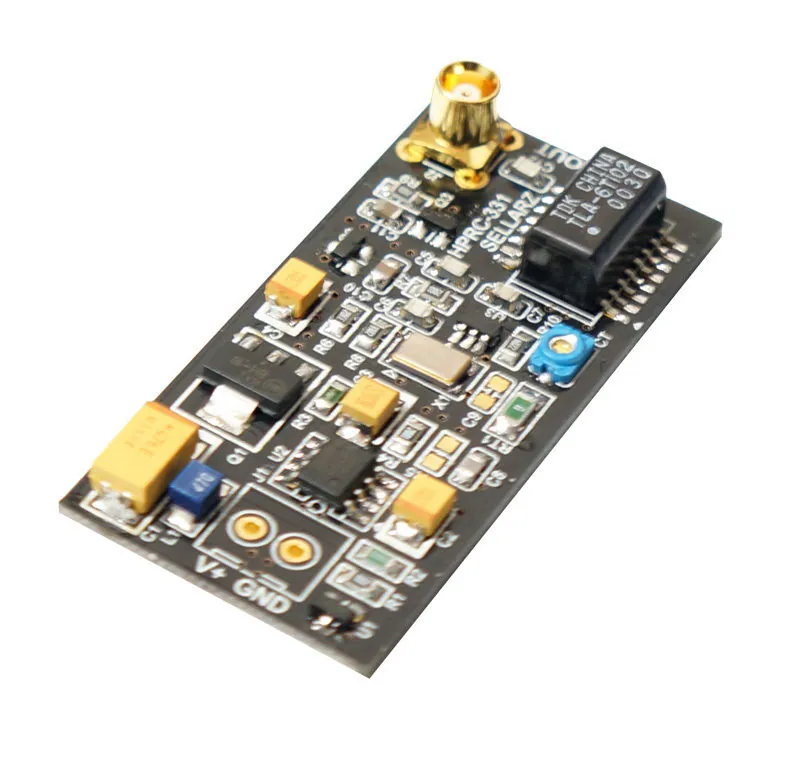

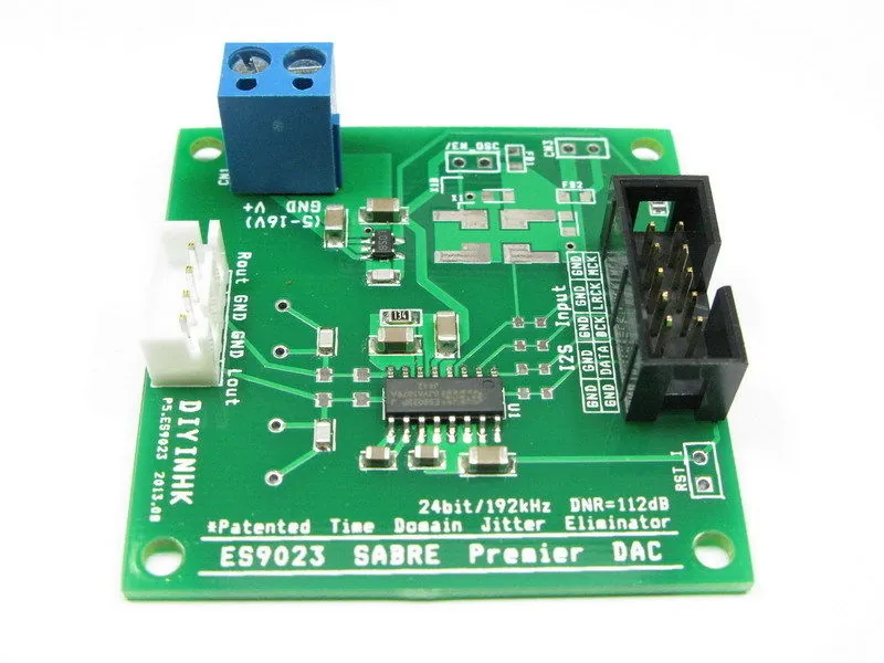

As most of us believe, ESS SABRE 9023 is one of the most interesting pieces of silicon around. I always wanted one hooked directly into my little PI. As raspberry pi i2s dac solution however, there is one technical issue preventing us to do that: Raspberry PI cannot deliver a Master Clock, which this DAC needs. So, let’s give it one! What you need is just get a ESS 9023 I2S DAC:
And pair it with a Master Clock Generator:
Then, feed both with DC voltage (you can use the same rail if you wish, the range is from 7 to 20 Volts DC). This should be a very effective solution, more pricey and complicated from the ones above, but you’ll be rewared with premium sound quality. And if you really want to get to higher levels, and also higher pricetags, you can choose to hook other fancy semiconductors:

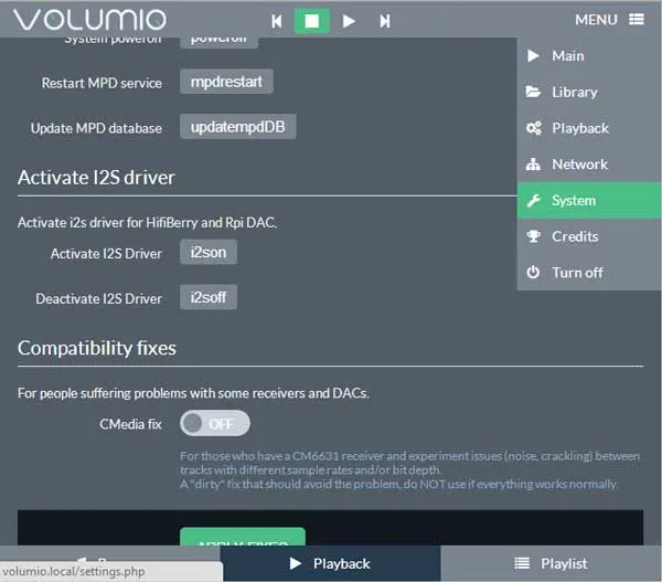

raspberry pi i2sThe last step is enable raspberry pi i2s DAC support from Volumio’s WEBUI, just go to settings -> I2S DAC -> I2S ON . Then reboot your PI, and enjoy the subtle joy of your one and zeroes flowing via i2s.
