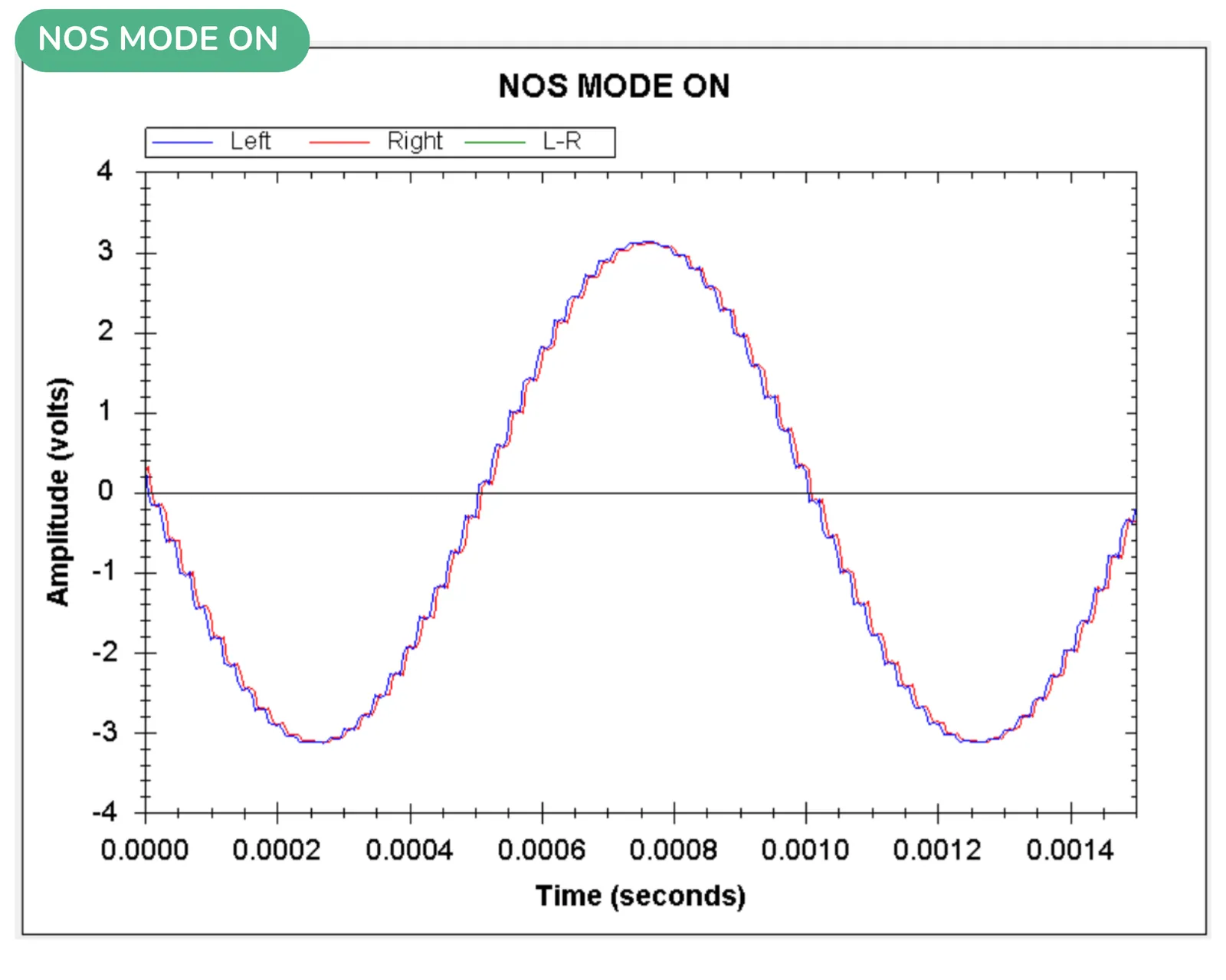

With Volumio Preciso, our high-precision dual mono DAC, you can activate NOS (Non-OverSampling) mode. This is more than just a feature. It is a different approach to audio reproduction that emphasizes timing, texture, and signal integrity.
What Happens in NOS Mode?
In standard DAC operation, incoming digital signals (such as a 44.1kHz file) are typically upsampled to higher rates before conversion to analog. This process helps reduce aliasing and simplifies analog filter requirements. However, it can also introduce digital interpolation and pre- or post-ringing effects that subtly alter the music’s character.
NOS mode avoids this process entirely:
No digital oversampling
No FIR or IIR filters
No mathematical reconstruction of waveforms
Instead, the original digital samples are passed directly to the DAC’s output stage. This preserves the natural timing and structure of the audio. While some high-frequency artifacts may be present, many listeners find that NOS mode produces a more natural, coherent, and emotionally engaging sound.
