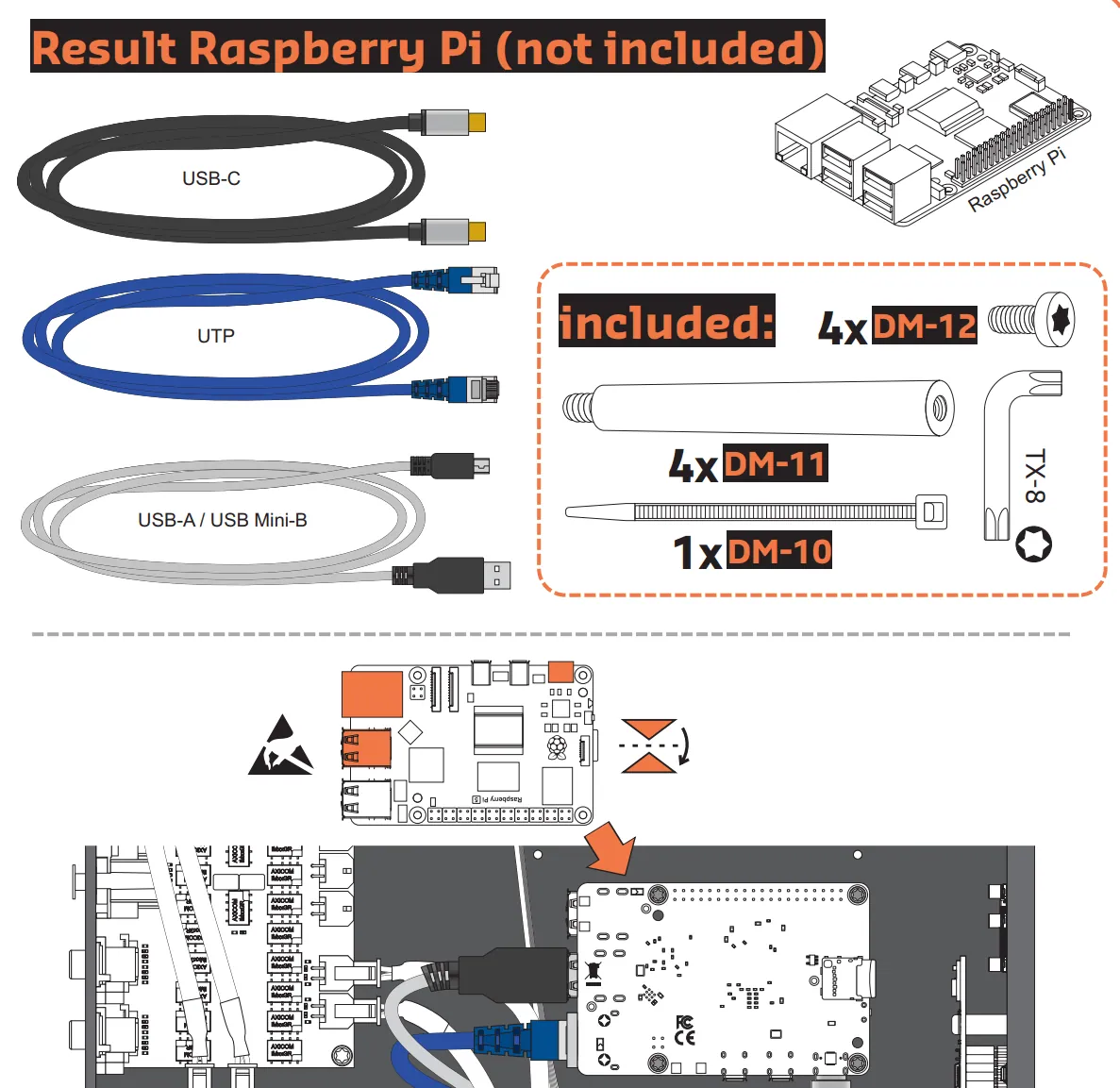

The Hypex DIY preamp made a great first impression, delivering on its promise of high-end, modular audio. While the kit I used didn’t include standoffs for securing the Raspberry Pi to the chassis (you can ask for them), this was easy to work around with a few extras from my toolbox. The included cabling is designed for versatility, and though I opted for longer wires from my collection, a more tailored solution could easily be added as an option for a cleaner look.
Aesthetics aside, the actual integration was refreshingly straightforward. Hypex clearly designed the preamp with Raspberry Pi compatibility in mind, and their manual made the setup process smooth and intuitive.

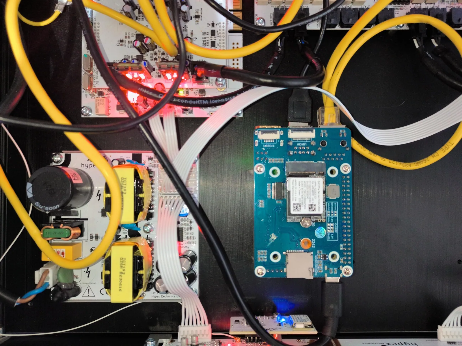

The Raspberry Pi’s WiFi signal is limited due to the full-metal enclosure—an expected challenge with enclosed electronics. However, for a stable connection, Ethernet is a highly reliable option. Users who prioritize wireless connectivity might consider a Raspberry Pi CM4 setup, which I’ll describe below.
Geek-Level Upgrade: CM4 + SSD = Refined and Ready
For those looking to take things up a notch, I tested a Raspberry Pi CM4 with onboard WiFi, mounted on a Waveshare CM4IO-BASE-A board and booting Volumio from an NVMe SSD.
This combination really shines with the Hypex preamp. It enables external WiFi antennas (a small hole in the back panel allows for clean integration) and supports faster, more robust storage options like eMMC or NVMe. The result? Quicker boot times, enhanced system reliability, and a polished user experience.
