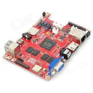

Volumio Audiophile Music Player for Cubietruck is out!
Cubietruck users, good news for you!
