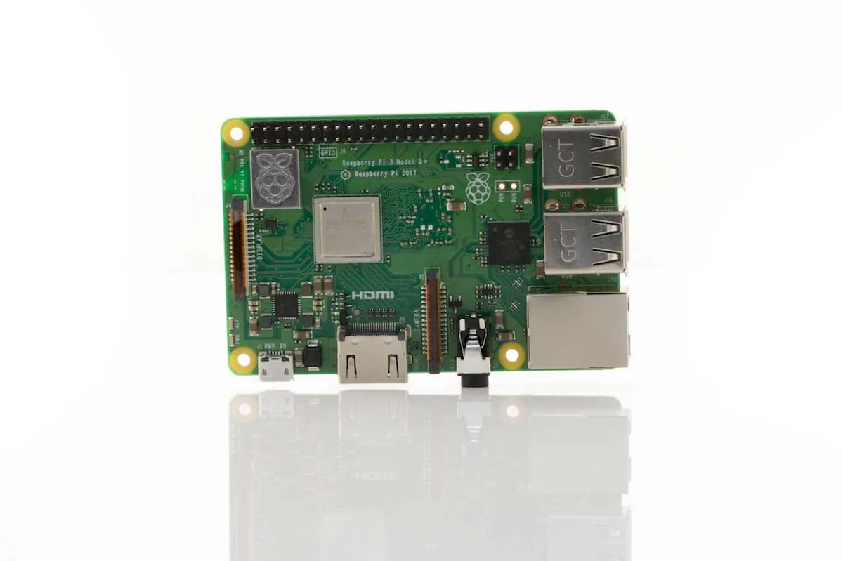

PROCESSOR
The new Raspberry PI 3 B+ is built around BCM2837B0, an updated version of the BCM2837 processor used in Raspberry Pi 3B. The most notable change is that processor speed bumps from 1.2 GHz to 1.4 GHz. As always, GHz are just a small part of the whole picture, and those extra 200 MHz are surely welcome, but surely not a gamechanger over the previous generation.
The foundation reports a real-life performance improvement ranging from 15% to 30%, but I would not expect to see a substancial difference while using Volumio. A potential impacting side-effect is however how this chip (and the whole board layout) dissipates heat, so let’s move to the next point.
THERMAL MANAGEMENT
The BCM2837B0 SOC incorporates power integrity optimisations, and a heat spreader (see the metal bit in the pictures?). Cleverly, the foundation used such features to get higher clock speeds, when temperature is below 70 degrees, and to throttle the processor only in extreme cases. Also, thanks to the on-board heat-spreader, thermal performance has improved.
Heat is not coming out only from CPU’s top, but it’s rather spreaded on the whole PCB, therefore applying an additional heatsink is not necessary anymore (and IMHO it wasn’t necessary with model 3 as well). It appears then, that the PI 3 B+ has been designed to be very well suited for long-time operations, even in confined spaces, without the need for an external heatsink.

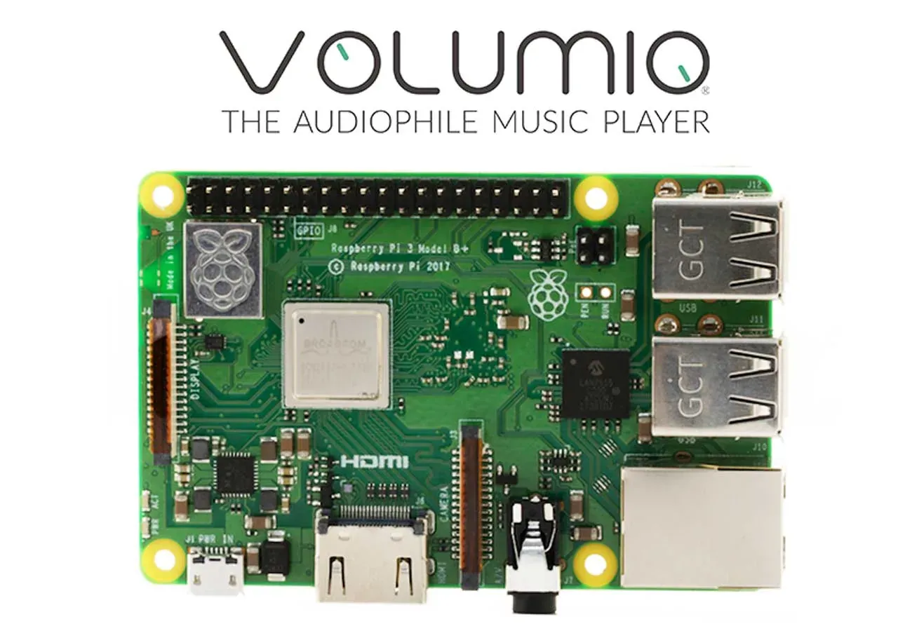

THE NEW USB HUB
Hidden within the new specs, comes a very interesting part. Quoting:
“Previous Raspberry Pi devices have used the LAN951x family of chips, which combine a USB hub and 10/100 Ethernet controller. For Raspberry Pi 3B+, Microchip have supported us with an upgraded version, LAN7515, which supports Gigabit Ethernet.”
This means that the new PI 3 B+ features a new USB HUB chip, and this might put an end to the PI’S first flaw in Audio-related usage, the USB bus package loss issue. If confirmed (we’re carrying out our tests and will update this article once done) this would be the absolute cherry-on-the-cake of this new Raspberry PI Model B+, and might justify alone the upgrade.
