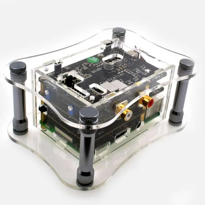

The Allo Katana DAC is definitely a learning experience: you have 3 boards stacked one on top of another (from the bottom: DAC, Output Stage, Microcontroller), and you immediately notice it’s full of Power Supply sockets, jumpers, selectors, wires…
So, in fear of making a mess, I immediately started to read Katana’s manual, immediately feeling like this thing needed a proper and cautious setup.
Long Story short: the Katana is not an easy plug and play DAC, it’s not for beginners and it’s not something you want to wire up the wrong way. Allo made sure their manual is clear and detailed, but surely I would not recommend to a novice of the Raspberry PI world to start with it (I will instead recommend getting the full player, we’ll see later why).
It reminds me the first sensations I had when back in the days I was restoring turntables: the constant feeling of dealing with a delicate equipment, that understanding how to treat it is fundamental to not make a disaster and that getting the most out of it is a matter of patience, study and effort.
If I shall make a remark to Allo: if there is a way to simplify the 3 boards, do it. As of now, it feels too complex even for expert users. I know for some this can be a good thing, but I definitely think that simplicity is the ultimate sophisticacy, and I don’t see an effort in this direction with the Katana.
With the Allo Katana Player instead, you get basically everything ready to play, configured, and packed in a nice case. I’ve no fear to say that at the moment, the Allo Katana Player (with Volumio of course) is the BEST Price\Quality ratio streamer on the market. And given how easy Volumio has become, and how good Allo packed this wonderful DAC, it’s definitely suggested for those wanting to get their first serious streamer.

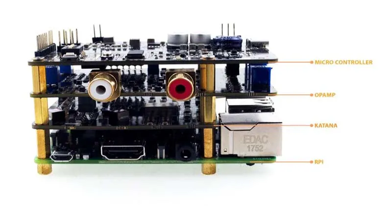

THE ALLO KATANA TECH 101
The Allo Katana DAC consists of 3 separated components, working together and stacked one on top of another:
The DAC board itself
This board hosts the pulsing heart of the Katana: the ESS9038 DAC, probably the most praised piece of silicon in the industry today (at least by Audio designers…). On the same board, we find also the ultra-low phase noise NDK oscillators for the DAC.
This has been Allo’s trademark when it comes to design: make sure the DAC works in Master mode (making it immune from Pi’s poor and jittery clock) and put excellent oscillators in the mix.
In my experience, such design choice results in excellent instrumental separation and great rhythm (every audio sample is played in the very exact moment it’s meant to).
The Output stage
That’s the really interesting bit in my opinion. Allo went all-in with an extravagant, but brave, choice: a class A opamp output stage. The first contradiction here is that Opamps are usually associated with bad sound, while class A is usually a synonym of top-notch circuitry.
The second point is that you would not expect to place a current-sucking class A design on top of a low power device (with no trace of heatsinking) like the Raspberry PI.
Ioan from Allo repliying to my questions, commented:
- Opamps are usually associated with Monolitic opamps (really cheap semiconductors that just get the job done, used where price and board real estate is crucial), while Allo has teamed up with an analog designer (sparkoslabs.com) that designs Opamps made with discrete components (they actually contain transistors, capacitors and resistors). Add that the analog circuit is designed (and trimmed) by hand, using premium capacitors, premium resistors and it runs in class A, Allo states that this output stage is completely transparent.
- The Output stage can be eventually turned off, by operating a switch on the MCU board (except when fed with +-15 external power). I initially thought that the MCU had the capability to detect the DACs idle state and turn off the output stage, but it turned out not to be the case. But this can be a really brilliant feature (mainly for those who leave their unit on 24/7) and I would love if Allo manages to implement it.
The Microcontroller
The ESS9038 DAC cannot be easily integrated into pure i2s implementations (like all Raspberry PI Audio shields), for a variety of different reasons. So the most common way is to stack a microcontroller between the PI I2S BUS and the DAC itself, and this DAC makes no difference. Therefore nothing special here.

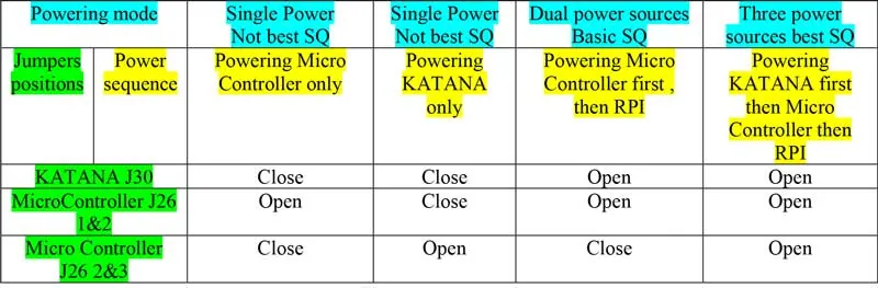

POWERING IT UP
The Katana is designed to be powered up in 3 different configurations (quoting Allo’s manual, from the worst in terms of Sound Quality to the best):
– Single power (1 5V 3A PSU, USB type C connector to the MCU Board)
– Double Power (1 5V 3A PSU, USB type C connector to the MCU Board + 1 5V 3A PSU, Micro USB Type connector to the Raspberry PI)
– Triple Power (1 5V 3A PSU, USB type C connector to the MCU Board + 1 5V 3A PSU, Micro USB Type connector to the Raspberry PI + 5V 3A via black and red wire)
– Quad Power (1 5V 3A PSU, USB type C connector to the MCU Board + 1 5V 3A PSU, Micro USB Type connector to the Raspberry PI + 5V 3A via black and red wire + -+15 Power Supply)
Quad Power supply is what theoretically will allow the best Sound Quality, although Allo specified that “A very good Power Supply must be used to get better results than our onboard regulators”. So what Allo recommends as best SQ in the manual is actually triple power supply, where no +-15 Volts requires to be fed. In this configuration, you need however to wire (and potentially solder, if you like clean jobs) two power wires carrying 5V.
I am trying the Katana Player in double PSU configuration, powering the PI with a generic 5V 3A power supply, and powering the Katana Controller board with an ifi iPower (to get the most out of this combination I’ve added an iFi groundhog, useful to get rid of any possible ground loop in my system).
My listening impressions are therefore related to this configuration (which is, with Allo’s words: medium Sound Quality settings), so I will try it with 3 different PSUs and update this review accordingly (although I won’t keep the system in this configuration, unless I see no less than Angels and Goddesses, since it will be a pain to have all those wires in my listening position, see later).
The worst part of this design choice is that achieving its full potential is quite a tradeoff: 3 different PSU are needed: 2 x 5V 3A power supplies, and a dual +15-15.
So, getting the most out of the Katana requires at least some electronic skills (playing with DIY power supply is potentially very dangerous if you don’t know what you’re doing), and you necessarily need to add about 100 euros to its base price ( to get the additional PSUs) and that the Katana player setup will involve a quite messy wiring scheme in your tidy electronic shelf.

There have been some mistakes in my review (I’ve corrected in the main text, but I’ll write them down here for those who like diffs):
- I’ve erroneously mentioned that “The Microcontroller unit is programmed in a way that it turns off the output stage when not used, saving power.” That’s not true: the MCU cannot shut down the output stage, but it can be done manually by switching a selector on the MicroController board (J27, assuming you’ve not powered the Opamp stage separately, in which case this jumper would be set to off anyway, getting power from +-15 external source).
- I’ve erroneously mentioned that there are 3 ways to power the Katana, while there are actually 4:
- I’ve written that “Opamps are usually associated with cheap designs”, but it would have been better expressed with “Opamps are usually associated with bad sound”

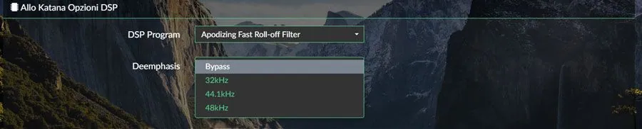

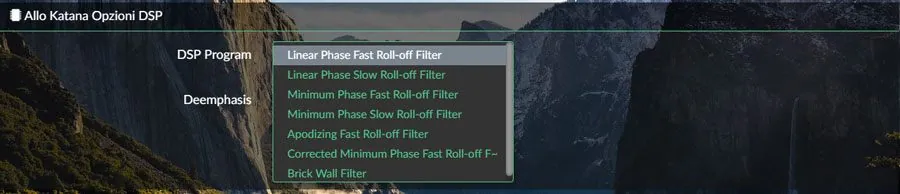

Another experiment I did was to change the DSP programs of the Katana. Volumio allows (from playback options) to change the DAC DSP on the fly, so it’s quite easy to evaluate their impact. You can choose between various DSP filters, and I found my sweet-spot on the “Apodizing Fast-Rolloff Filter” (if I recall correctly that should be the default one).
Coming to deemphasis, I noticed that selecting 44.1 kHz removed the “harsh” effect on the high range that I experienced in my Studio setup. On the other hand, selecting this value while playing on my main gear felt like removing “the real deal” from the musical message (so on my main setup, I do not use deemphasis by selecting “Bypass”).
